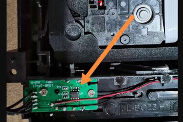

Some claim there is a solution to use Oppo FW with a Blu-ray drive by adding a controller board to the disc drive, but I found no one selling it.
do you mean this board that was added to the optical drive? yes there is such a player named Pannde but Javier does not want to develop purchases in this price range unfortunately .... I can not even find it in any Chinese store this player to find out the price but I know what it looks like at least. ..
as far as I know, this player is not on oppo firmware, but on a modified pioneer firmware
There is a version in which this board is sold with Oppo, but we need to contact the seller to specify the price
