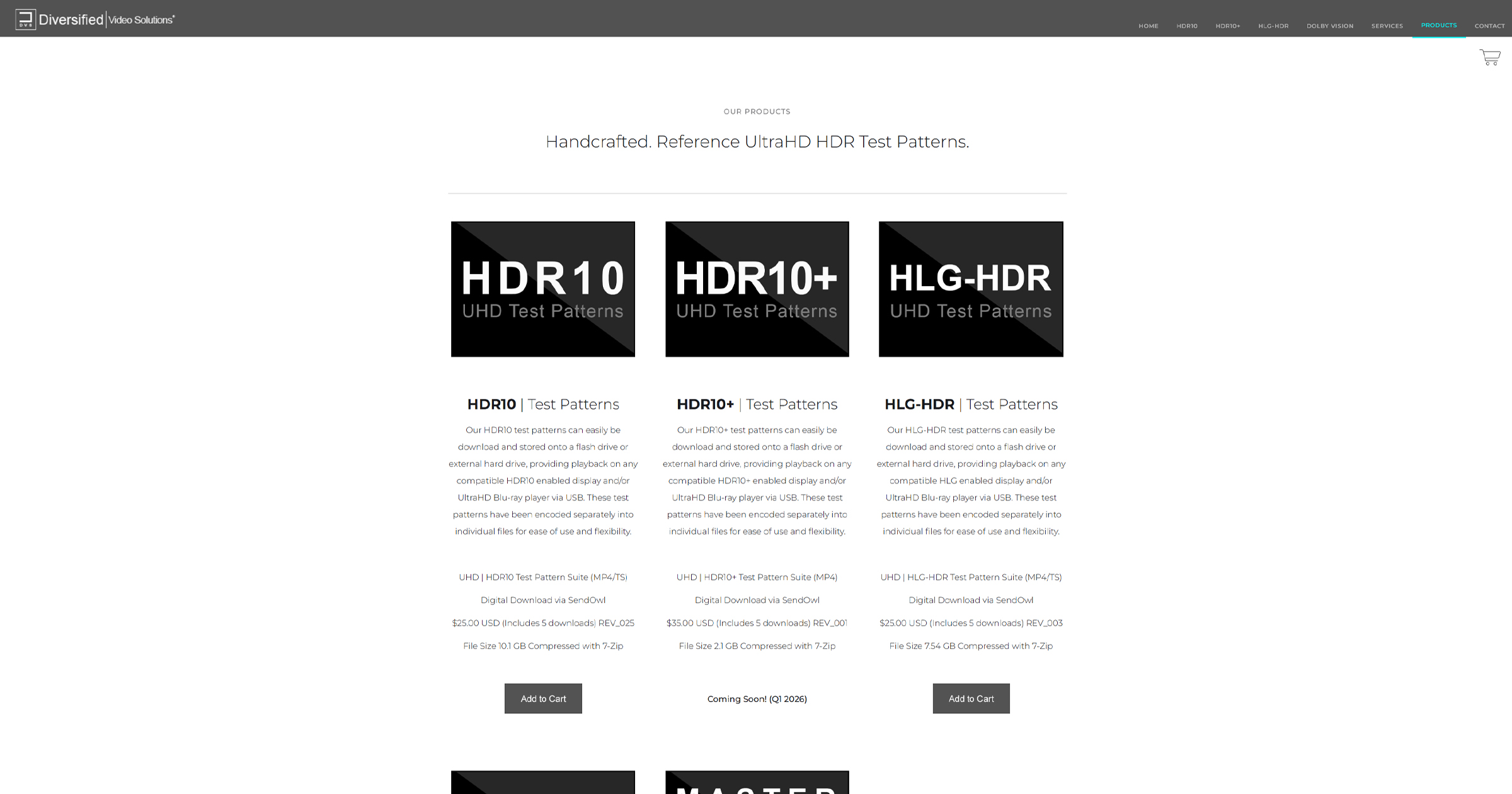

Handcrafted. Reference UltraHD HDR Test Patterns.
A comprehensive set of reference 4K UltraHD test patterns that encompass all of today's latest HDR standards. HDR10, HDR10+, HLG-HDR, and Dolby Vision. Our products come in a variety of options from downloadable digital file sets, bundled packages, we even provide a fully authored UltraHD-HDR...
