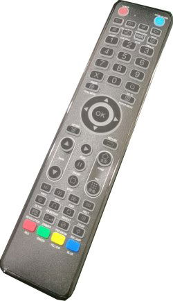

Pictures: Motherboard cooling shield v203 + English remote update.
M
    194.1 KB · Visitas: 210
